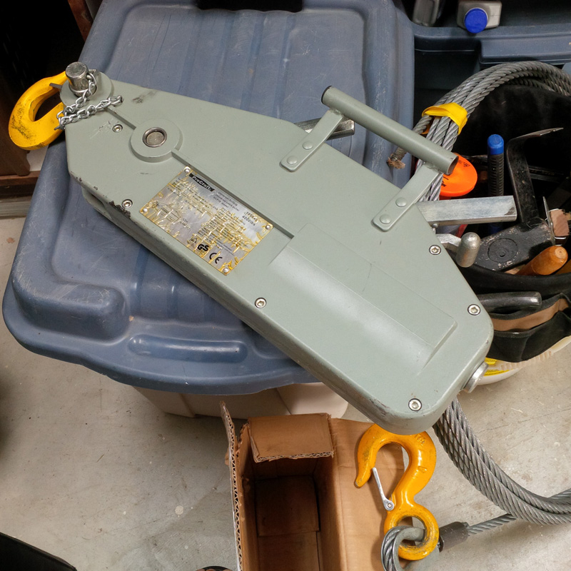

Tirfor's are a very handy tool. I bought one from Wesco Industries in Burnaby, BC (
http://www.wescovan.com/ ). Image below. 4000lbs capacity, uses 11.5 mm wire. Also picked up a Campbell Chain, shackles, wire rope and straps. They have a lot of good stuff and prices are decent:
