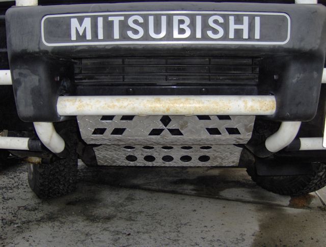

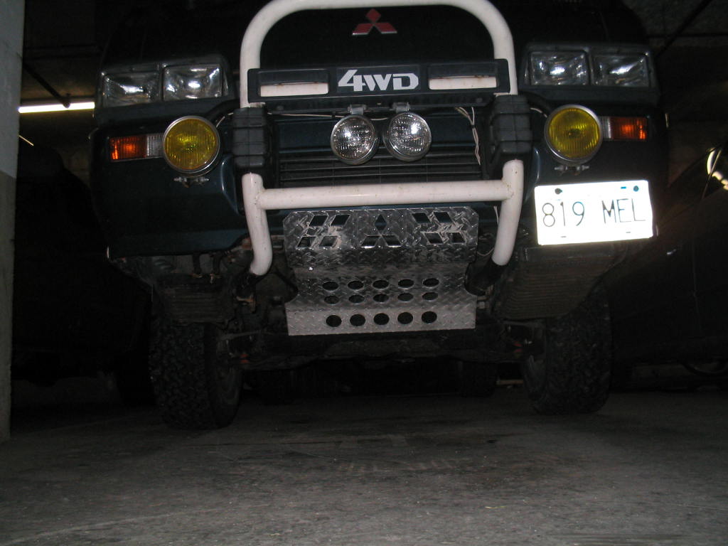

Can we see a picture of the whole front end, I think I want one. My only concern is with the extra coverage in front how much will it effect cooling?

I believe that was part of the design process with input from people in hot places (like Australia) who have similar designs and no overheating issues.dfnder wrote:...My only concern is with the extra coverage in front how much will it effect cooling?
Re: Skid plate, pictures...
See page 14, not exactly the same but it sits the same. Combine that view with Fexlboi's picture and you should get a good idea of what it looks like.dfnder wrote:Can we see a picture of the whole front end, I think I want one. My only concern is with the extra coverage in front how much will it effect cooling?

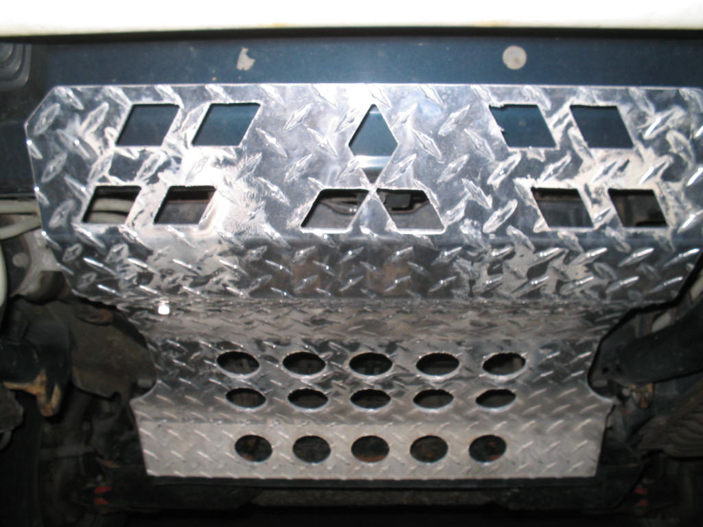

Fexlboi, you must have really big fat fingers 'cause it was quite an easy install for me. Could be that my truck was on a hoist? In all, it probably took me 5 min. to put it up, just start a few bolts so it stays in place and slowly work you way. The trick with the lower passenger side bolt is to position your wrench with it's "tail" facing the driver's side it that makes sense.
It's not the stongest/best design but we had a decent template, it does the job and anything more complicated would have been a lot pricier. I had the thinner plate before (same design) bashed it really good on many occasions and it held real good so this one will be even better. The bottom attachment is actually quite strong and will keep this plate where it belongs...

Hi all! I just installed my skid plate and it fit great. However, warmland89 was at my house with his '89 and there is no way it would have fit his. There is no place for the back two bolts and the bends are not right. So if you have an '89 and are wanting one of these maybe check first. I am not sure if it is an '89 thing or maybe some vans are slightly different.

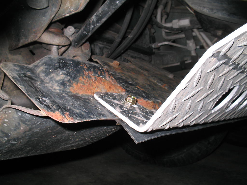

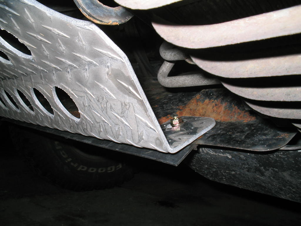

Thanks Isaac for putting my plate on,fits good.I'll move the a/c filter up & out the way later.
Looks really good, Shaun. Nice pictures, too.

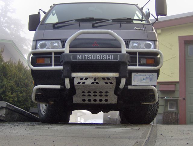

We were planing to go to Victoria this wknd and to pick it up at ccautos on the way though, but Nellie-dog barfed all down the inside of the bus between the bench-seat and the wall just as we left the driveway
So this morning I got out there under the bus and bolted it on. It was a little tricky, but not too bad. I ended up removing the rubber strip along the base that is held on with 8mm bolts so the plate lies flush and not on the little bolts. The attachment bolts on the driver's side were a piece of cake, but the passenger side were more work, esp. the one at the front. It took a little finessing and careful pre-placement of the washer and nut inside the upper pan - and several attempts...
Nice picture, Kona.... Looks skucum on the mighty Hazel
