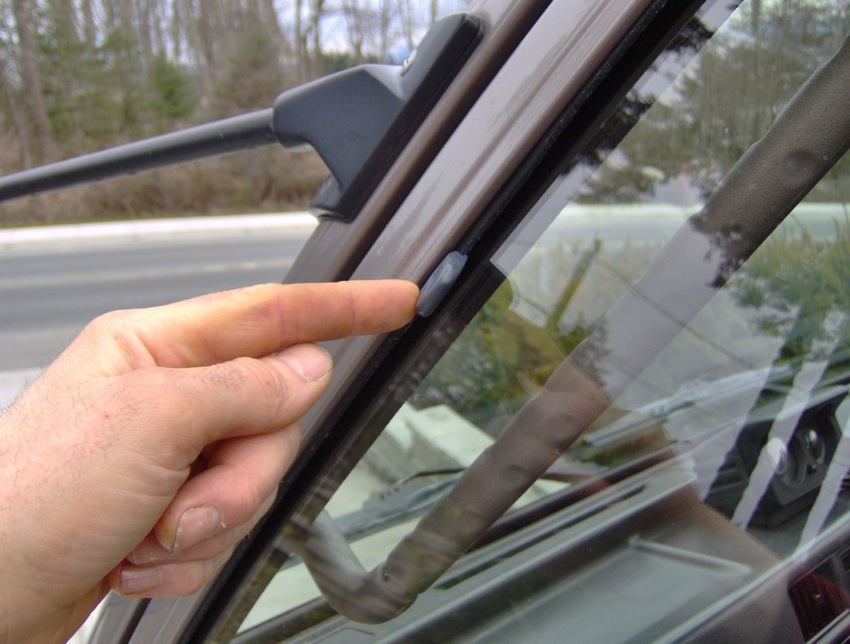

Anyone have a picture of these clips correctly installed?
Re: front door window rattle
Posted: Thu Mar 26, 2009 2:52 pm
by konadog
Hope this helps:
Posted: Fri Mar 27, 2009 6:51 pm
by Erebus
Chances are, if you look closely at your monsoon guards, you will notice a cutout that is intended for the clip. If there isn't then you have a one-or-the-other choice. But with the monsoon guards in place you shouldn't need the clips.
To install, you have to pull out the weatherstripping/channel that the window rides in. It is easiest to start at the back top of the door, pull it down gently (it is only pressure fit into the metal channel), then work your way to the front, then down the slope. The clip just snaps into the metal channel. If you have the monsoon guards on, it is the same, except if I remember right you might have to remove the guard to install the clip.
Should be fairly evident once you start. Good luck

beautyful
