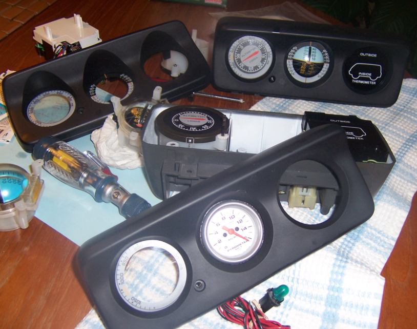

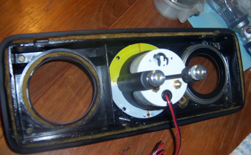

				I'm going with Garyo's style. I was going to put it below the stereo but din't like to have it hidden down there. I prefer to have it "in my face". And that inclinator kept leaking on me so good excuse to replace it. I'm keeping the altimeter 'cause I probably use it more to tell what's coming weather wise than my altitude. The in/out temperature gauge is staying for now but might get replaced with a boost gauge, not sure yet. I've properly set my boost now (from 7psi up to 12) so I'm happy for now.
The gauge is a Autometer model 4344 (2 1/16"), you need to trim a little of the faceplate to make it fit in that whole but fairly easy.
