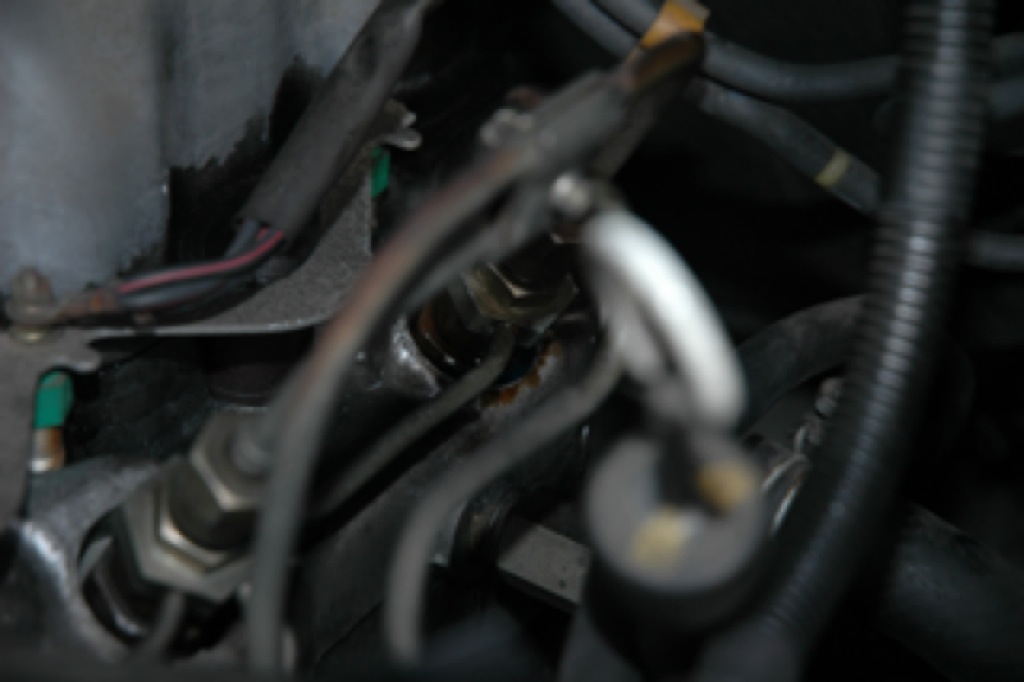

Right, so i was about to get started getting to the ECM when I noticed that there is a small puddle under the front where there wasn't one earlier. Took a whiff and it sure smelled like gas and not oil or anything else. Crawled under and saw that there was a drip coming from the bolt closest the drivers side tire that holds on the skid plate (think thats what it is) so I decided to take the thing off and see what was under it... nothing wrong that I could find, nothing wet, no streaks or lines of fluid or anything, but the under side of the skid plate has it all along it. So I pop the "hood" to try and figure out where the gas can be coming from then I see this:
Little bit hard to see, but obviously the injector (again if thats what that is) furthest to the back of the engine is leaking a bunch. Everything else looks dry except for that place, could I have found the solution? I even saw it bubbling a little even with the engine not turned on.

by bae146
Yup that is your injector leaking....

by g_man1972
Would that be the solution to the smoking problems? Because I am pretty good at always checking for little puddles under my cars and this one is very new, maybe last few days or so. It is possible that it has recently got worse and was leaking only a little bit before, not enough to create a puddle. Mardy, if your still reading, wouldn't they have caught this during my service?

hi, O.k. yes, or no, as we dont know when this thing going,
as you can see its probably the injector washer that cause the leak. not common problem but sometime it leak need to tighten or change new seal.

by g_man1972
Hi all,
For those that are following this tread because you are having similar problems, I took it back to CVI yesterday and they were very good at fixing the leaking injector for me. The smoke is less, but not totally gone. They are very confident that what is causing the excess smoking is the govenor sleeve, a easy way to check is that if you are in neutral and hit the gas if it takes a while for your revs to go back down to idle than this is the problem. Like if I put it up to 2500rpm and let off the gas right away it takes a good 3-4 seconds for the RPM to drop back to idle, it shouldn't do this and should drop much quicker. The reason for the smoke is that the govenor sleeve is sticking and therefor supplying to much diesel when the engine is under load. My explaination may be a little off, but thats the jyst of it. Does that make sense? Hopefully that helps some of you out, not a cheap fix unfortunatly but good info none the less.
