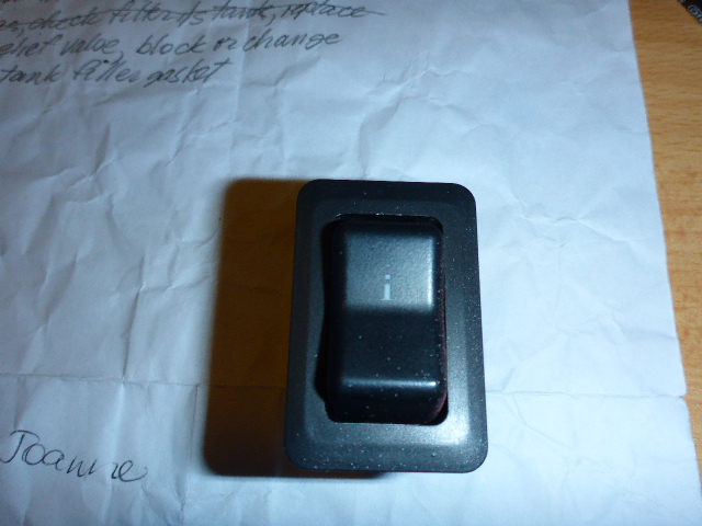

The chrome one in the corner of the left front bumper? Its a curb finder? What actuates its extension?
I noticed the four proximity sensors (still operational) facing outwards at all corners, but didn't know about any curb finder, lol. Thanks!
CyKlops Delica L400 Cruiser
Posted: Tue Dec 27, 2016 6:03 pm
by thelazygreenfox
up toggle switch like this on the dash.

thelazygreenfox wrote:up toggle switch like this on the dash.P1020634.JPG
I should have known, lol, exactly what it looks like it should be... thanks!
*EDIT
I should add, that toggle utilizes a relay that I hear clicking somewhere under the dash, but nothing happens to that antenna... I noticed an unplugged thin grey antenna-like (but thinner) cable in behind the stereo-deck area, perhaps that's related, and was unplugged for a reason?
