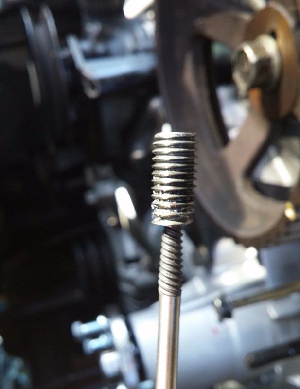

About time for an update on my project. IT RUNS!! I sure was pretty fking stoked when she picked up and screamed to live on half a crank. I had those damn belts of half a dozen times redoing this and rechecking that. Pull a broken bolt from the block. Drill, tap and helicoil a new thread. Re time everything. So far just a couple of drips after driving around the driveway. And the power steering seems to be sealing up. We'll see under harder use. Pretty sure the pump is on it's way out. Warms up pretty good. Here's a rundown.
  • Broken and stripped upper silence shaft tensioner 'bolt'.
  • Helicoil repair
  • Pulled the trans pan. Standard aluminum 'fuzz' on the magnets. No chunks.
  • Cleaned the filter, new fluid
  • Full oil change, filter, black as tar... Will probably drop in some sea foam and go for another change well before the next 5k
  • Fuel filter change, prime, etc... (have never done this before, it was fun to learn)
  • Bolted up all the various pulleys and pieces. (wow the allen key in the ring gear worked like a dream).
  • Dropped some Diesel Fuel additive in. Also have some Marine 2stroke to use after this first batch of gunk.

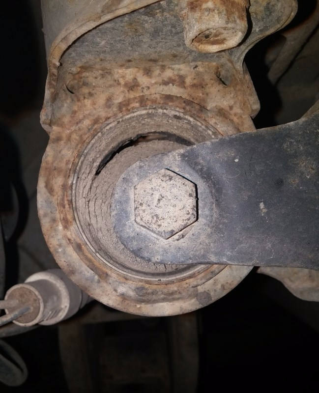

I just saw this under the carriage. It appears to be the Driver Side transmission bracket? And is looking really aged. :) Anyone know of an l300 getting wrecked anywhere? What's the compatibility on these? They look to be at least $130 when I was able to see one similar online.

Those bushes look messed up. I've only been able to source them from Mitsubishi if you buy the whole crossmember, but if I ever figure out a compatible replacement I'll let everyone know. No luck so far.
