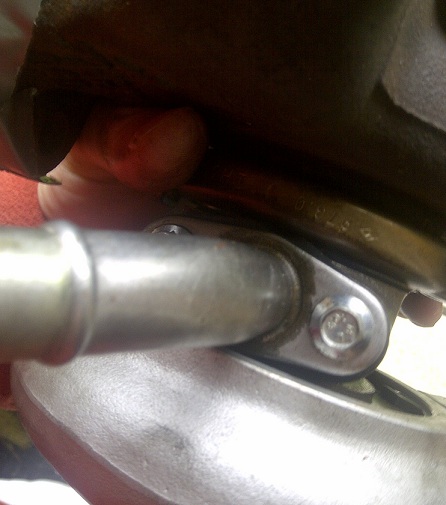

I have the gasket from my old broken turbo. Just to check, it is for this area?
regards,
Re: I think I've blown my turbo.
Posted: Thu Jun 06, 2013 12:33 pm
by str8gooods
Yup, That's it
