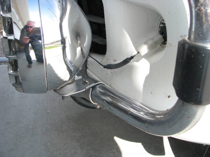

I first decided to start with my fog lamps.

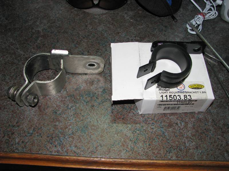

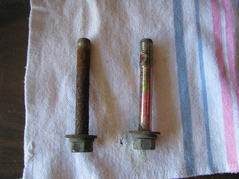

Fog Lamp Bracket OLD
Comparison between brackets

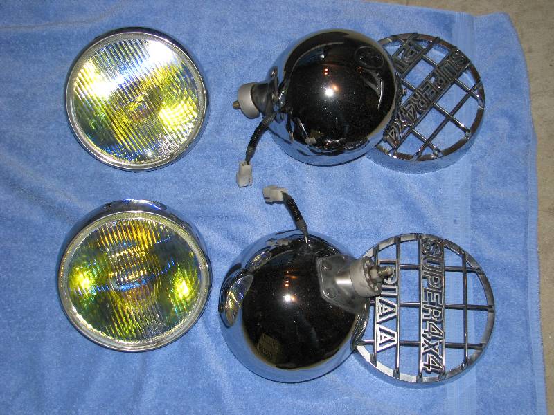

Spiffy lamps
Spiffy lamps
One has never worked since I bought the van, so I was considering upgrading to a new set but I really do love the gigantor look of these things. This almost never came to be as my mechanic here in Edmonton accidently ran the non-functioning one into the hoist and cracked the grill and dented it a bit. I had almost given up on them but he glued the shield back together and I decided that since I have spent so much money on other repairs (another long story) that I will have to live with them. A couple weeks ago I decided to turn them, or it, on and to my surprise there were 2 working. By the time I got home I had only one again so I decided to check out the wiring. Seemed to be some sort of short inside the lamp. Fast forward to a couple weeks ago and my new Rugged Ridge brackets came in. They are sweet and so much more sturdy than my old ones. So I took off the lamp in question and VERY carefully was able to slide the protector off without cracking it. Once I removed the lense the culprate was visible. The wire going to the H3 Bulb was burnt and completely severed. So I have ordered a new set of bulbs off Fleebay for a very reasonable price. I cleaned the whole lamp inside and out so it is ready to go back on.

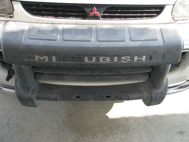

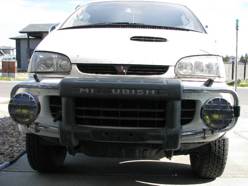

Front end before 2
Front end before 2
Front end before
Front end before

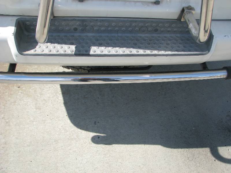

Rear step
Rear step
Now I have run into a snag. It is not as easy as I thought it appeared to remove the plastic shroud from the bull guard. I removed the 4 visible screws and popped out the few remaining plastic rivet things (which all broke BTW - so if anyone has a bead on new ones I would love to get my hands on them) and it is still on there tight. Does anyone have any experience in taking the thing off (Jesse)? After careful deliberation I have decided to paint. Krylon Fusion Satin Black. I am going to pick off the remaining letters and paint it up. I have picked one off and they leave behind this gummy adhesive crap. Anyone know how to remove this? I was thinking rubbing alcohol or goo gone. I was going to leave it black with no letter but I put out a call to our brothers overseas as I remembered seeing that someone on ebay.uk was selling them. Someone (forum name hillbilly - ironic I know) responded that he had bought some for his van and lost them, then sold the van and found them - so he offered to send them to me airmail for free! Sweet - many thanks for that. So anyway, once I get some info on how to remove the shroud I will post more pics. Sorry for being long winded but I am babysitting as my wife is working and our kid is asleep so I am bored!

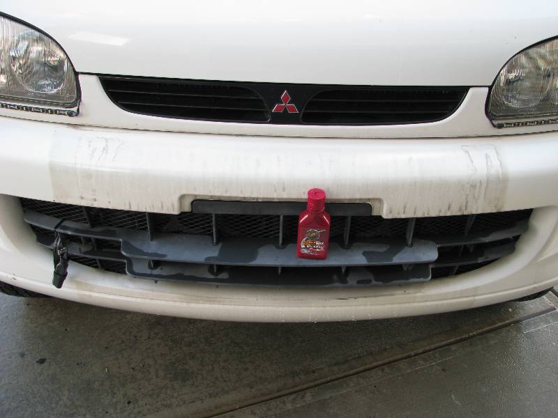

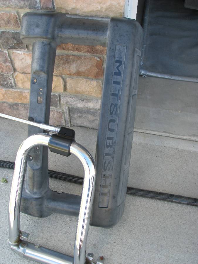

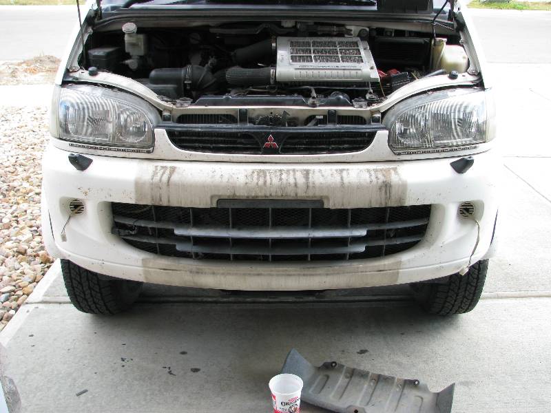

OK Round 2 - Removal of Bull Guard.

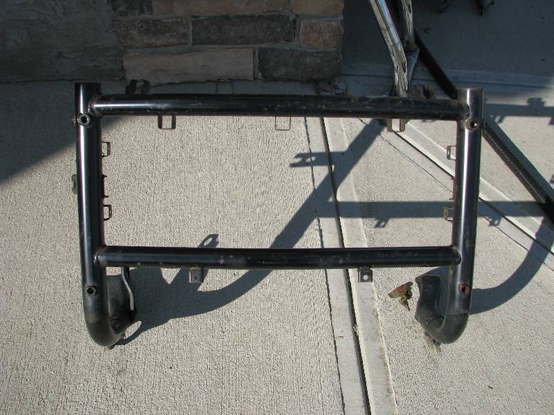

I found through asking a lot of questions on our overseas friends website that the best way to get the shroud off is to pull the whole bull guard. They even supplied me with schematics on how to do it, but it was not very hard. 4 bolts in the front and 3 underneath (One is up a ways so you will have to remove the plastic shroud covering your oil filter. Once off I found some amazing things. Besides the van now looking like a Pontiac Firefly on Steroids, I found 17 years worth of grime, a few rusty bolts and a rather large dragon-fly (may not be Japanese though as we do have a lot around here!)
So I took the bull guard apart as it is in three sections and the shroud cam off very easily. Pressure washed everything and have it ready to paint. I am going to use some Meguires cleaner wax for all the areas under the shroud so that it will hopefully to keep some of this gunk from sticking around.
I have a few questions to ask all the Guru's:
Should I try to replace some of the rusty old bolts with new ones?
I am going to repaint the middle section of the bull guard since it was under the shroud rusting a bit. What kind of paint should I use (I was thinking Rustoleum) and should I prime it first?
Does anyone have any recomendations on how to clean chrome? I found some rust on the chrome and I am not sure what to do with that.
Thanks - Back in a few days with a completed paint job.
