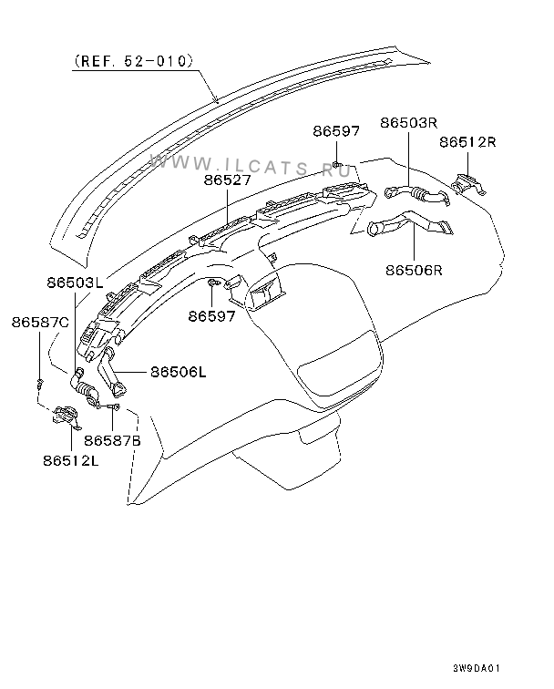

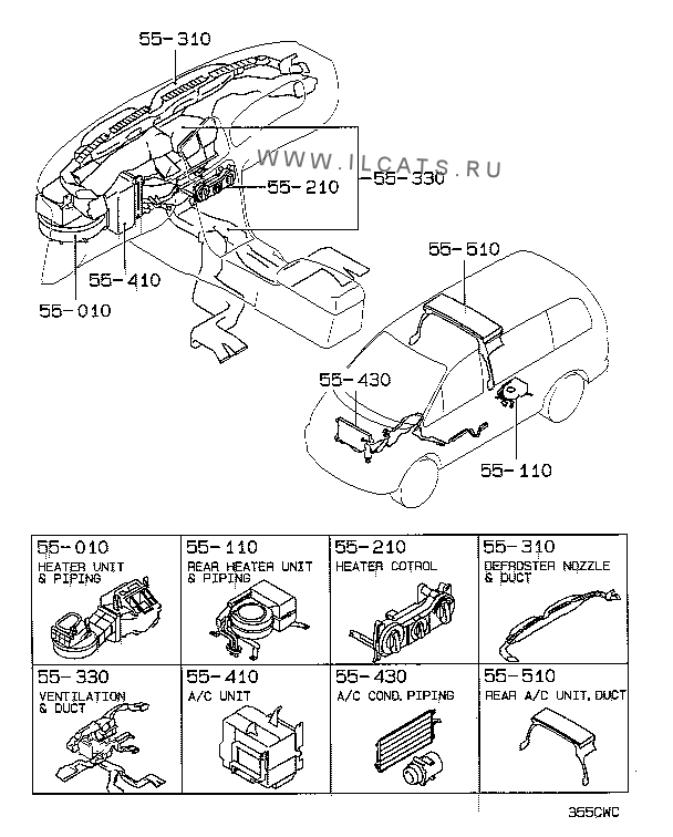

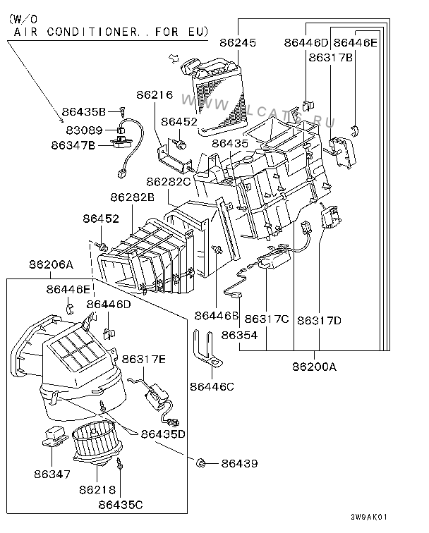

Craig, I would spend the time focusing on the air duct. The heater sucks air from just below the wipers at the back of the hood. The exhaust fumes fill the engine compartment and escape at the back of the hood where they get sucked in the heater inlet when you are idling or at a stop.
This may give you a better idea of the ducting.
http://www.neoriginal.ru/cat/mitsubishi ... NUFL6/55_0
If you have the time, I wouldn't hesitate to pay 1-2 hrs worth of labor to an exhaust shop if they can trace it. That would be my first choice if I was not able to source the leak by myself. Sometimes a new set of eyes and experience goes a long way.

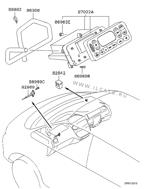

Not sure of which face plate (heater control) you have but if you do have the one with the air sensor (small 1/2 rubber tube that plugs in the back of the heater control bezel), then the exhaust may be seeping in through there.
If you don't have it behind there, then you can disregard this one. Have a beer.
