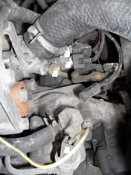

The temperature sensor you mentioned (#2 on the picture) in conjunction with the tranny ECU is responsible for the 4th gear but the tranny temperature is not the only factor affecting the shifting pattern.

Checked the sensor Profister, Djelica and Gleen at CC auto talked about and indeed there was a sensor unplugged. I've fix it and waiting for the day at work to be done to go out for a drive!
It actually look just like that: http://i219.photobucket.com/albums/cc95 ... CT0204.jpg
I'll keep posted on if it worked out well!
Thank ya'll for your help!

It works! So the censor was indeed the problem!

Weird. My 2006 L400 (diesel) does not have the sensor pictured above as sensor #2. There's not even a hole for it. When I was having OD issues, the sensor that appears to have been causing the problem (corroded...connected needed cleaning) was the coolant sensor shown as #1 in the above picture. The OD was dropping out randomly at highway speed. The sensor terminal is non-weather-protected and prone to corroding.
Re: Overdrive Problem
#1 you are referring to has nothing to do with coolant or the TPS. It's the sending unit for the oil warning light.jcolvin wrote:Weird. My 2006 L400 (diesel) does not have the sensor pictured above as sensor #2. There's not even a hole for it. When I was having OD issues, the sensor that appears to have been causing the problem (corroded...connected needed cleaning) was the coolant sensor shown as #1 in the above picture. The OD was dropping out randomly at highway speed. The sensor terminal is non-weather-protected and prone to corroding.
Weird, fidling with the sensor seemed to help. Ok, where is my OD coolant temp sensor then? Sensor #2 does not exist on my deli. There is a combo sensor in front of the injectors, one terminal goes to the glow controller and the other goes to the temp gauge on the dash. Unplugging this has no effect on the OD. Do 1996 delis not have an OD temp sensor, or is it hidden somewhere else?jfarsang wrote:#1 you are referring to has nothing to do with coolant or the TPS. It's the sending unit for the oil warning light.jcolvin wrote:Weird. My 2006 L400 (diesel) does not have the sensor pictured above as sensor #2. There's not even a hole for it. When I was having OD issues, the sensor that appears to have been causing the problem (corroded...connected needed cleaning) was the coolant sensor shown as #1 in the above picture. The OD was dropping out randomly at highway speed. The sensor terminal is non-weather-protected and prone to corroding.
