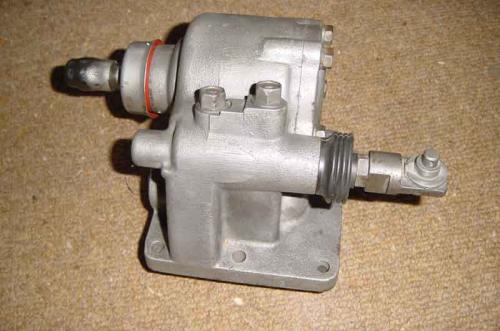

In case someone on this side of the world want to proof a PTO winch can be done on a l300.
Here are your first parts: http://forum.ih8mud.com/sale-parts/4745 ... er-bc.html
