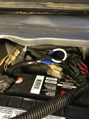

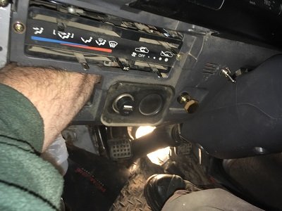

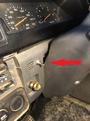

Thanks for that link, sck_nogas. I considered the battery isolation switch but decided to just isolate the offending circuit: Lights.
I installed a simple toggle switch in the dash
and wired it in just behind the fusible link junction box (down stream from the fusible link). I used spade connectors so it will be easy to reverse if I ever track down the drain.

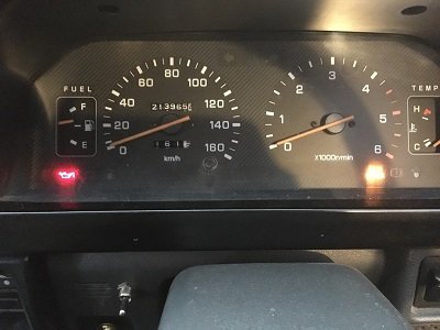

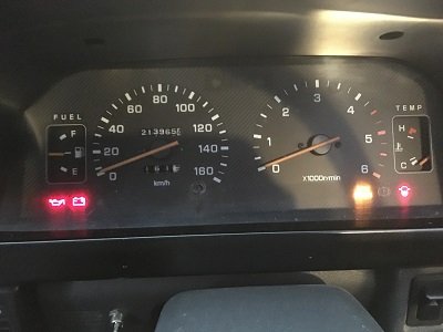

So, here's a new twist. One of the other little jobs on the list was to fix the fuel filter indicator/glow plug indicator that stopped working a few weeks ago.
With the new switch turned off the fuel filter lamp works (as well as the battery indicator which I hadn't even noticed wasn't working).
switch off.jpg (18.96 KiB) Viewed 9421 times
With the switch turned on neither works.
switch on.jpg (22.02 KiB) Viewed 9421 times
Any ideas what this could mean? Does it indicate where this parasitic drain is?

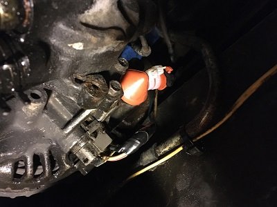

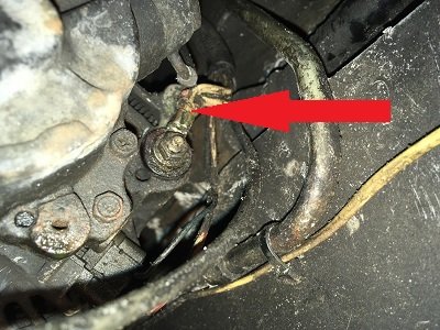

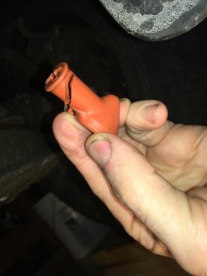

The next job on my list was to replace the radiator hoses and thermostat. As I was removing the thermostat housing bolts I dropped the ratchet and it hung up in the wire loom below...and the loom started to smoke. On closer inspection the smoke was coming from the connection at the alternator where the protective rubber boot had split and the wires were grounding to the alternator body...parasitic voltage drain found!!!
parasitic drain1.jpg (41.06 KiB) Viewed 9395 times
parasitic drain2.jpg (18.54 KiB) Viewed 9395 times
I cleaned up the wires and the broken boot (I couldn't get a new one locally today) and gooped it all up with dielectric grease and zip-tied it back together. I reoriented the wires a bit so they weren't touching anything.
parasitic drain3.jpg (25.34 KiB) Viewed 9395 times
So, now I have a toggle switch on my dash that does nothing...maybe I'll use it for a manual glow plug switch....another day...
And all my dashboard lights are working properly again! I need to study the wiring diagram. None of this seems logical in the slightest...
