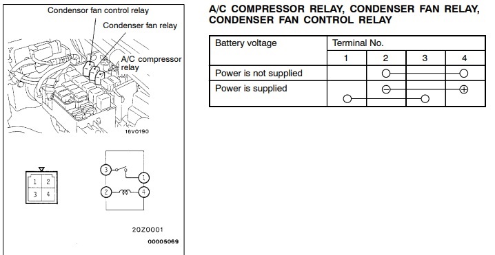

Hi guys, I read through the l300 ac wiring thread in the technical library, but am having a difficult time understanding and trouble shooting the system. I cannot find the ac compressor relay as pictured in the thread. Ive had my delica for almost 2 years now and finally just got the ac charged. I took it to a shop, and although it took awhile to cool down it was working... I was SO stoked as i live in arizona. Well right after i had that done, one of the roller bearings on the rocker arms broke so the van sat for around 2 weeks while the parts came in. I just finished installing a new rocker arm and adjusted the valves, and now the ac compressor is not engaging. no click from the relay, no engine rpm change, nothing (side note, is there supposed to be a light behind the AC switch?). I dont know where to begin even after having grazed through that thread i mentioned. The + from the compressor is plugged in, and the thermo switch is plugged in by the coolant hose. i unplugged and replugged in the big relay behind the glove box... is the big one right center behind the glove box the relay for the AC compressor or is it a different one?
Where the heck is this?
ac compressor relay.jpg (64.62 KiB) Viewed 8774 times
I would reallllly appreciate a more simple walk through of where to check first. TIA

Whoops. The AC workshop manual mentioned in that thread is for a different vehicle (the Pajero) and isn't entirely correct for our engines. I think I mentioned that in passing, but I've gone back and made it more clear. The correct L300 AC manual has since been found- you'll need to download the entire workshop manual from here: http://www.delica.ca/forum/viewtopic.php?f=17&t=17809
Troubleshooting: easy things first.
-Check the fusible links in the battery compartment- one of them runs the entire AC compressor system, independently of the heater/fans. If the AC fusible link is broken the heater fan will still work, you just won't get any AC.
-Try applying 12V directly to the compressor clutch wire (unplug it from the loom first). If the AC clutch goes "clunk" then it's working.
All the AC electrical bits (relays, secondary fuses, timer/control module) are mounted behind the glove box, which you'll need to remove. The first thing to check would be the 3 glass fuses clipped to the front of the evaporator box- they're in white plastic holders. Above those, at the top of the evap. box, are the AC relays. Below the fuses is the AC timer relay- it's a black box, but on mine the label says "AC timer". That box delays AC engagement by a few seconds to prevent the compressor from "chattering" (between 5 and 20 seconds, by my reckoning, depending on its own internal logic, which I haven't entirely figured out yet). The full throttle switch, for example, causes the timer to turn off the AC for about 10 seconds.
The AC switch has a light in it, but it's only for night time illumination. It's usually green, but there's a flap of yellow filter in the switch which makes the AC lettering glow yellow when it's turned on. If the headlights are on. Basically, you can't tell if the AC switch is good by looking at its light.
