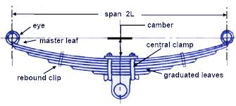

The rear suspension workshop manual (http://www.delica.ca/forum/viewtopic.php?f=115&t=18456) says 4WD Mini-Bus rear springs should have an unloaded arch (camber) of 125.5mm (4.94"). Camber is measured from the centre of the eyes like so:
