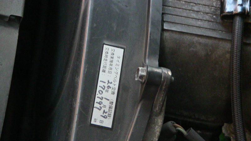

Is there a sticker on the timing belt cover that looks like this? Mucho thanks to Growlerbearnz for the translation....
The date on that sticker is 2014 -01-29. There is a DIY tutorial in the Tech section on how to do it. Seems intense but not impossible. It also seems like it's a very expensive (I've read quotes of 2 grand..) job done at a shop, when the belt's (Timing AND balancing belt) and tensioners seem to run around 150-200 bucks.

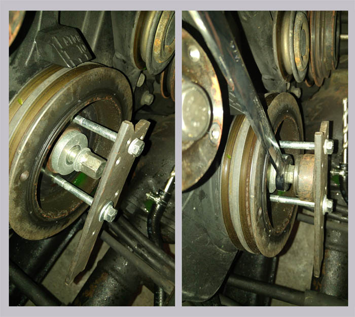

Both those threads imply that the crank pulley will just come off once the bolt is removed. I've never been that lucky. Regular gear pullers don't seem to work very well, I've had to improvise a special tool like so:
Loosen the crank bolt, then find/make a thick piece of steel bar, holes drilled at each end, bolted into the crank pulley. Then unwind the crank bolt to push the bar out. Add spacers as you run out of length.

Found a sticker affixed to the timing belt shroud. The penned in writing was so faint that I had discounted it as a timing belt change designation. Upon taking pictures of the decal with flash on and flash off it looks as if it's the mileage the timing belt was changed. It looks to be marked 86,6xx km and the odometer is at 158,xxx. I feel a little more reassured considering the mileage is still under the recommended 80,000km interval ,but I will be changing out the timing belt etc very soon as I have no indication of how many years ago the change was made.
Thank you again for the pertinent info.
