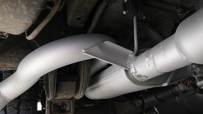

The old side-exit exhaust was kind of an experiment. Thrown together from old bits I had lying around, its main purpose was to make room at the back for an extra fuel tank. Making extra boost and power wasn't an unwelcome consequence either. The noise, though, has become irritating, especially when towing. Time to build a proper exhaust system.
buy a bunch of parts:

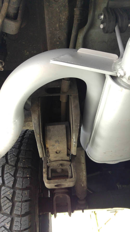

...and build a new system. Side exit, but with a full-size silencer as well as a bullet style resonator. Exhaust tip aimed slightly downwards too, to hide the occasional belch of black smoke. (Pictured here upside-down and backwards, just for confusion. The large u-bend goes around the right side front leaf spring mount, if that helps).
And installed- (terrible pictures, sorry, it's night time now :-))
It's much *much* quieter than the old one. I'll have to do a lot more driving to see what effect it's had on EGT and boost levels, but since I've gone from 2.25" to 2.5" I'm hoping for only a little impairment, despite all the gnarly bends.

Innovative and clever. Now the silly part.... Did you use the heat gun to heat the exhaust before bending it? LOL
I had to ask.... :-D :-D
MD
Re: New and improved side-exit exhaust
LOL I wish. It's to cure the high temperature exhaust paint- for best adhesion and strength it needs to be heated to various temperatures and allowed to cool. Easier to do that off the vehicle.
Sure! I used (in order from exhaust flange):
Existing exhaust outlet flange- was previously bored out to fit 2.25" tube
2x 45 degree 2.25" (57mm) bends (for the downpipe- 2.25" clears the retaining springs, two bends moves it away from the bellhousing)
1x 2.25" to 2.5" (63mm) flare (just before the hotdog style muffler).
500mm long 63mm inlet/outlet louvered centre tube hotdog muffler (the louvres make it quieter, but I suspect they've given it a slight whistle. I'd go for a perforated centre tube if I was doing it again. Open side of louvres face the engine).
255mm x 105mm oval 63mm in/outlet offset/offset straight through muffler (I didn't want to risk the flow loss of a chambered muffler)
Half a 63mm donut for the sharp turn.
A short length of 63mm pipe- my bends had fairly long tails, so I just used a piece off one of them.
1x 180 degree 63mm bend (conveniently wide enough to go around the spring hanger)
1x 90 degree 63mm bend
Recycled exhaust tip.
I've since had to add a bracket to stop the exhaust tip vibrating at about 1500rpm:
You can probably see in the above photos that I had to double up the right side exhaust hanger as it was taking most of the weight. Doubling it up also stops the exhaust from moving sideways too much and hitting the spring mount.
