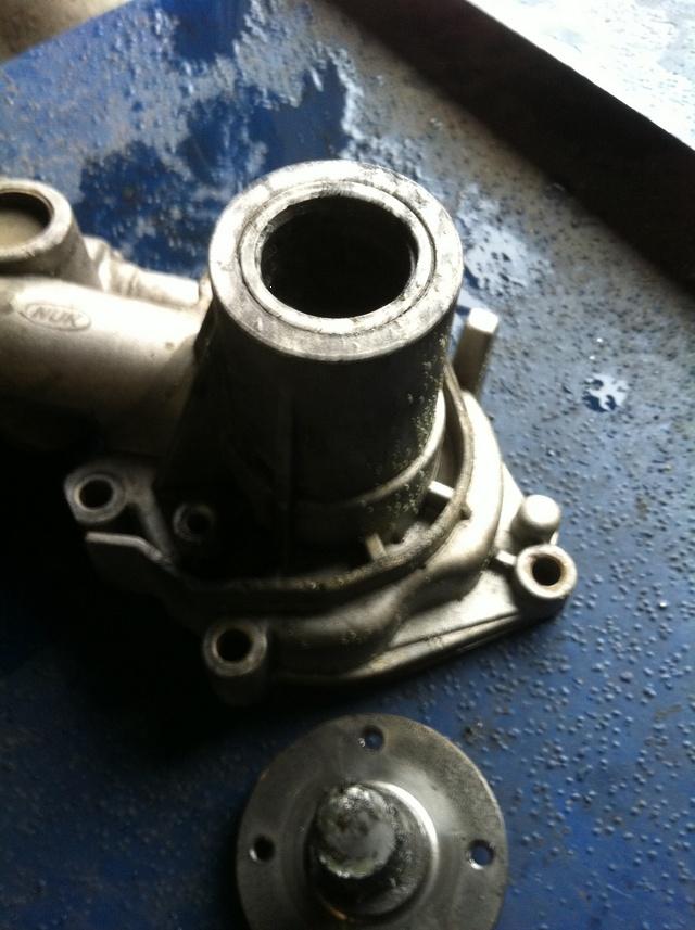

I have been getting "loose change" sound coming from my engine for a couple weeks then.
Progressively got louder. Gave Butch a quick call. Decided to take it in that morning.
Started the van and POW! (Batman style) engine stopped and rad fluid down the curb within seconds. I thought it was rad hose.
Towed to CVI. The tow was more exciting then taking transit home.
No-name brand water pump Japanoid put in when I bought the van.
I was lucky. Water pump cracked at home. Could have been worse.
I used to have fluctuating temp gauge.
Replaced everything relating to coolant system.
Improved, but never dropped below 1/2 mark. Always 1/2 to 2/3.
Good news!
Temp gauge has not climbed above 1/4 mark since replacement of water pump.
Woot! Woot!
Thanks Butch/Edwin for getting me up and running ASAP!!!
-Delooka

Hey Delooka, how'sitgoin',eh? Do you recall what the brand of the "no-name" water pump was?

Hey Falco, it's a going! Thx!
Edwin and Butch did not recognize it.
So to me, that makes it a no name brand.
