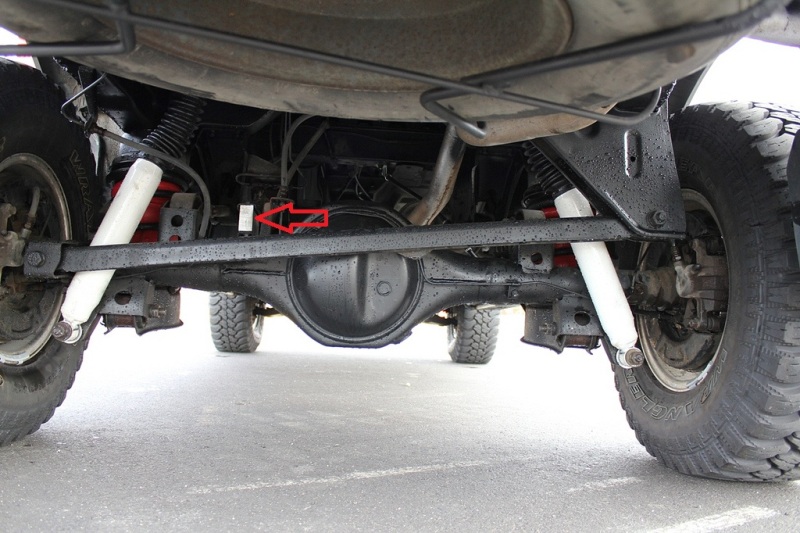

Funny....I was going to post a question similar to this topic. I am onto my 3rd rear brake job!
I am assuming that the rear brake compensator is messed up because of the lift. The last time I checked things I looked for it but couldn't find it. Can someone out there describe where the rear brake compensator is or better yet take a quick photo of it for me....please please.
-Mark
-Mark
Re: A few brake questions
here you go. Two bolts (12mm socket) and it slides forward/back.
Guys and Gals
Before you adjust the brake proportioning valve mark your starting point with a scribe or sharp tool. It's difficult to see where you started from or how much you moved the parts.
Mark it, adjust the valve, load the van and test the rear brakes for lockup on gravel. If both the rears lockup backoff the adjuster.
One wheel lockup means additional brake work.
Rear lockup on rain or ice is dangerous, be careful.
Thanks! Seized caliper replaced and backed off the valve a little....the adjustment was all the way tight so I'm guessing slacking it off a little will help.
