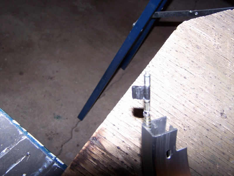

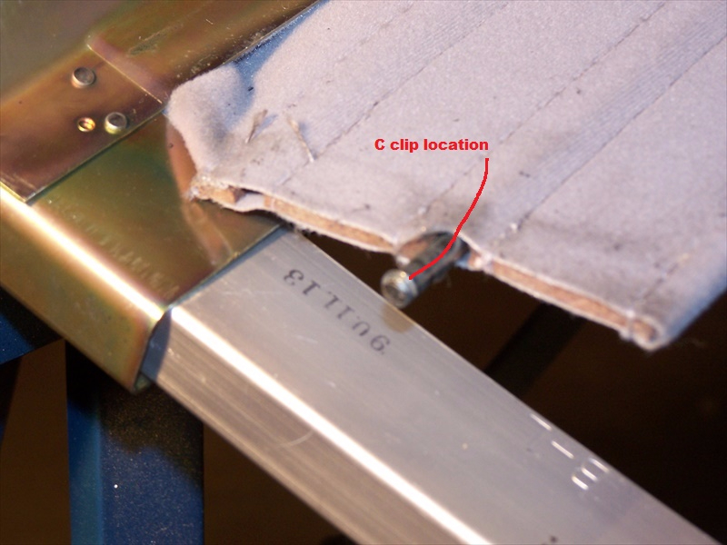

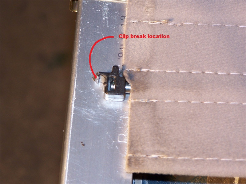

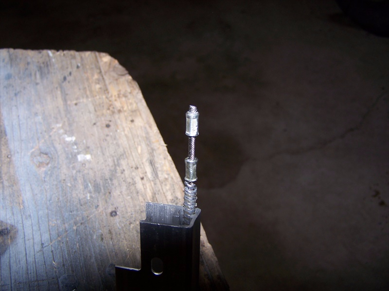

The broken clips need to be removed before the new clips can be installed. The pieces left on the cable and blind are very tough. I found a pair of wire cutters and a hack saw worked.
- Blind rod with broken clip
- 100_8070 1a.jpg (370.24 KiB) Viewed 6461 times
- Blind rod with clip removed and C spring clip in place
- 100_8073 2a.jpg (340.87 KiB) Viewed 6461 times
- Broken clip on push rod
- 100_8075 3.JPG (406.49 KiB) Viewed 6461 times
- Broken clip removed
- 100_8074 4.JPG (289.21 KiB) Viewed 6461 times

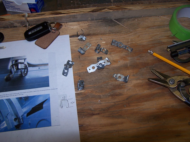

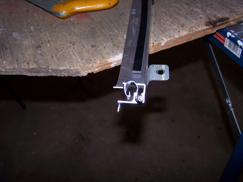

Bending the pipe strap to fit in the channel so it will hold the rod takes a little practice. The important points when creating the clip are to have the large hole end up in the center of the channel opening to hold the rod and have it operate without binding. The trimming of the strap to allow it to be bent/pinched around the cable is critical to getting the large hole in the right position. The shape I used is slightly different than Jamie used as the first set I installed let the blind rod pop out. Bending the clip to reduce the distance between each side of the blind seemed to solve the problem. Jamie provided good comments and pictures in his post so it is worth reviewing.

- Test clip
- 100_8076 1.JPG (316.94 KiB) Viewed 6460 times
- More practice test clips
- 100_8077 2.JPG (441.71 KiB) Viewed 6460 times
- Final clip rear
- 100_8081 3.JPG (309.67 KiB) Viewed 6460 times
- Final clip front
- 100_8082 4.JPG (385.99 KiB) Viewed 6460 times

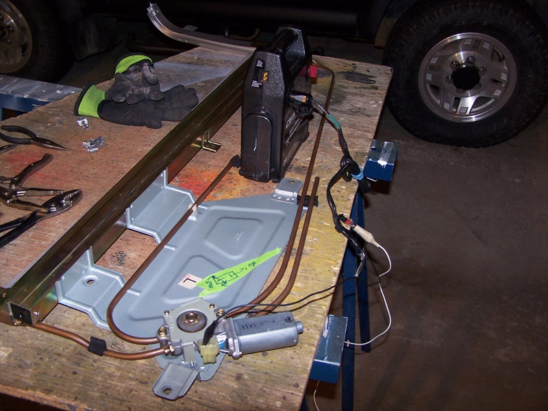

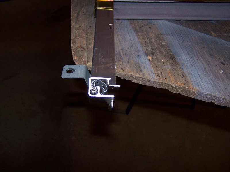

I used a test 'bench' to operate the blind and test the clips. I found it valuable to make sure they don't bind. To bend the clips I tried needle nose pliers, pliers, vise grips and a vise. All I can say about the process is be patient and beware of metal fatigue. The 12V fused supply was very handy as several of the clips got wedged in the channel and blew the 5A fuse.
- Test ' Bench '
- 100_8083 1.JPG (481.65 KiB) Viewed 6453 times

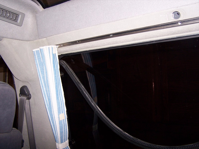

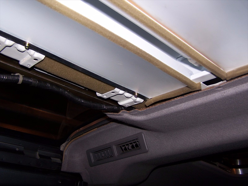

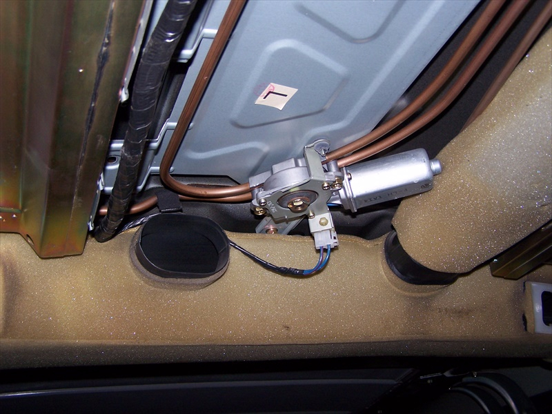

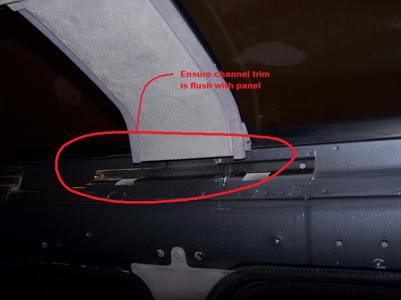

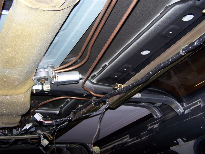

- Center area after florescent light removed
- 100_8047a.JPG (398.49 KiB) Viewed 6453 times
- Rear panel area
- 100_8049a 1.jpg (469.41 KiB) Viewed 6453 times

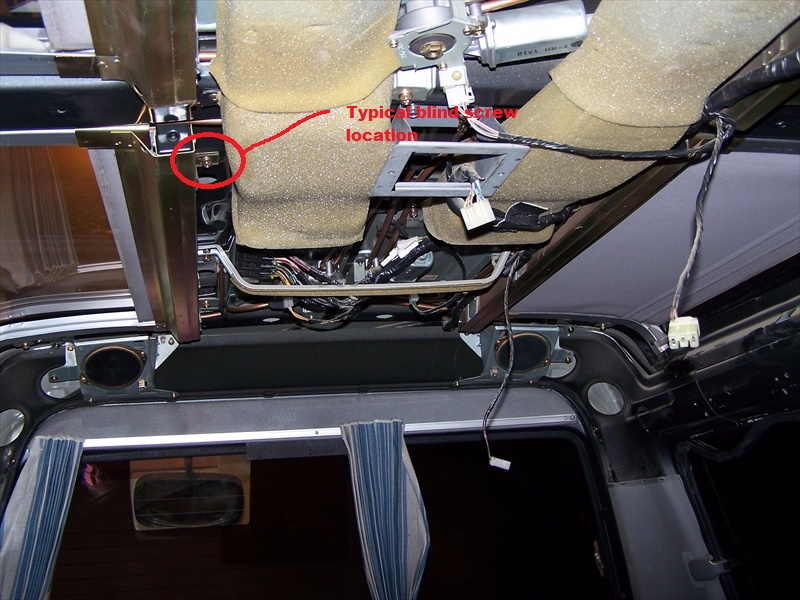

- Front blind area
- 100_8050a.JPG (490 KiB) Viewed 6453 times
- Front area one duct removed
- 100_8051a.JPG (454.48 KiB) Viewed 6453 times

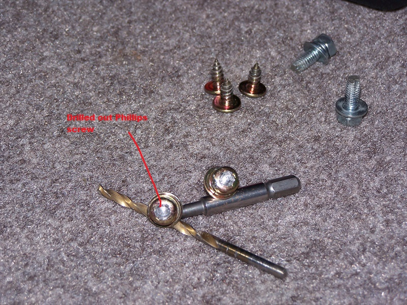

- Drilled screws from florescent light support
- 100_8053a 3.jpg (675.54 KiB) Viewed 6453 times

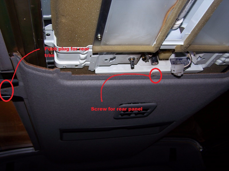

Remainder of pictures for install. Good luck and be patient for those who do this repair!!

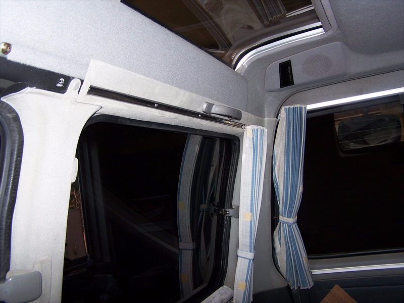

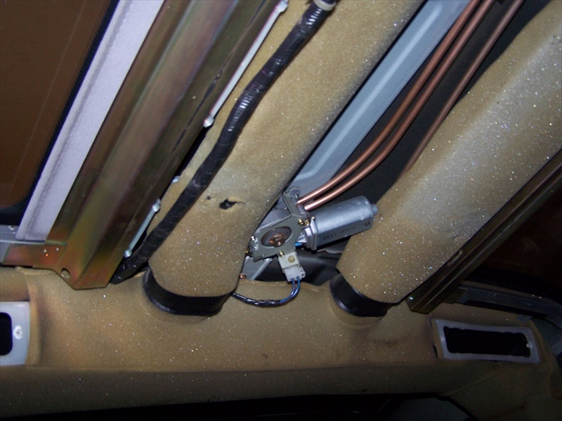

- Rear panel @ center light
- 100_8092a 4.jpg (350.3 KiB) Viewed 6453 times
- Front area - center light
- 100_8093a.JPG (332.6 KiB) Viewed 6453 times
- Trim between CL glass
- 100_8094a 5.jpg (339.05 KiB) Viewed 6453 times
- Rear window curtain trim
- 100_8100a.JPG (347.92 KiB) Viewed 6453 times
- Front window curtain trim
- 100_8101a.JPG (351.88 KiB) Viewed 6453 times
