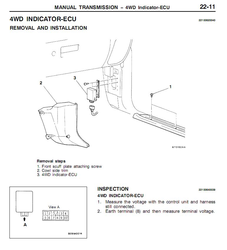

I am reviving this thread hoping that someone knows by now what exactly controls the 'wheel lock' bulb. The pulse generator which has been mistakenly referred to as the 'wheel lock sensor' is not capable of switching the bulb on/off on its own. All it does is signaling that the front drive shaft is rotating either by the t-case or by the front hubs. This leads to the conclusion that there is an ECU of some kind controlling the 'wheel lock' bulb. I wonder if our reputable mechanics can put some bright light on this non-documented topic. Where is the Black Box?

The black box seems to be specific to the Manual Transmission.
Butch would know the answer to this question.

Nope, this picture does not apply to the case. I already went through all the sources including Australian, UK and Russian forums; hit a dead end.
Edit: RichD, if you bring this picture closer to your Delica and compare one to another you will end with scratching your head... :o
So, we are looking for an ECU that is analyzing the status of a 4WD/2WD sensor and the rotation of the front drive shaft (pulse current provided by the pulse generator in the t-case). The 'wheel lock' light will tell you the truth only if the front hubs work properly i.e. if the auto-locking hubs are broken and do not lock but the front drive shaft is engaged by the t-case the 'wheel lock' light will be lit because 2 conditions take place: 4WD is engaged and the front drive shaft is rotating. The light will stay ON if you switch the t-case to 2WD but the front hubs are locked causing the rotation of the front drive shaft.This is why the indicator works with either auto-locking or manual hubs as far as everything works according to the programmed logic. Literally it serves one purpose: dummy protection.
Now, to the best of my knowledge the only ECU in a L300-brick is so called 'glow plug controller'. It looks pretty sophisticated for only this purpose; you do not need a microprocessor and a couple of dozens of transistors to glow 4 plugs. The only picture of a glow plug controller I found was the one provided by Mystery Machine in conjunction with the locations of the glow plug relays but it had only 1 connector on a PCB. My ECU (let me call it this way) has 2 connectors. What is this bunch of wires for?
I do not believe our reputable mechanics did not solve this 'mystery' which should be documented somewhere unless this information is classified. :shock:
