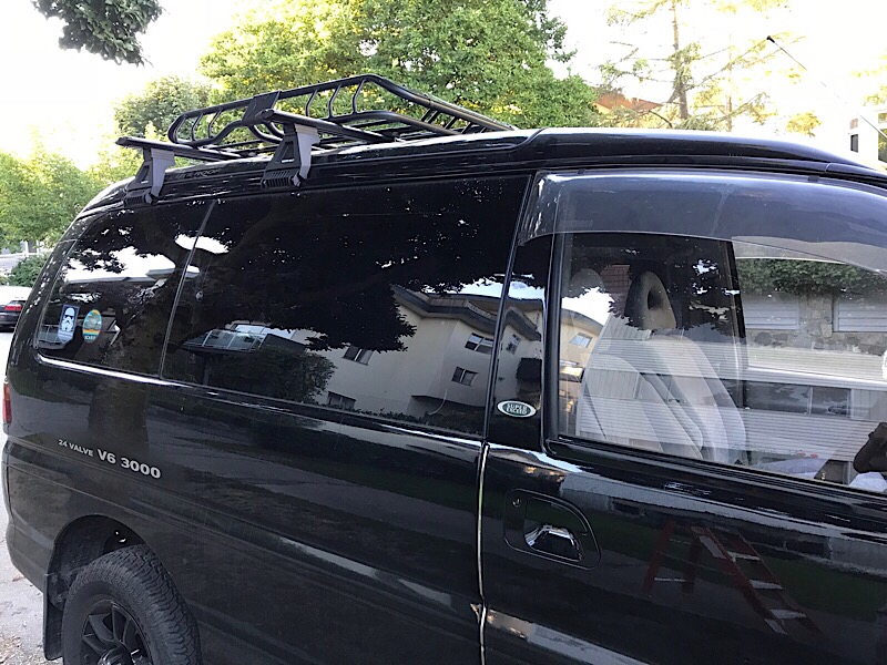

Finally got my roof rack and basket for my solar panel on the ol’ L400 Royal Exceed

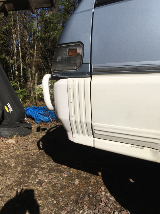

Fabricated two liscense plate adapters. Mounted plates. Looking fine

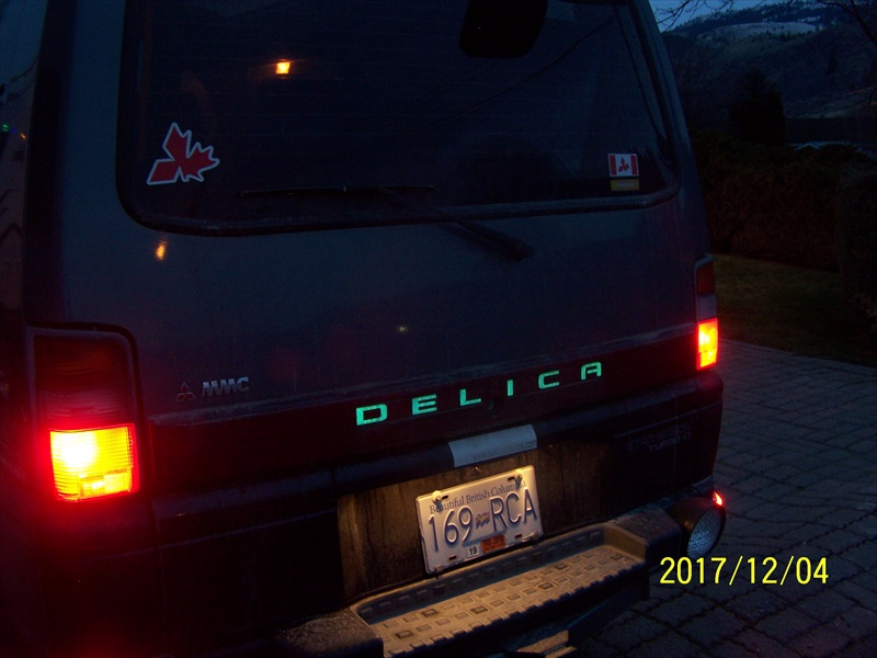

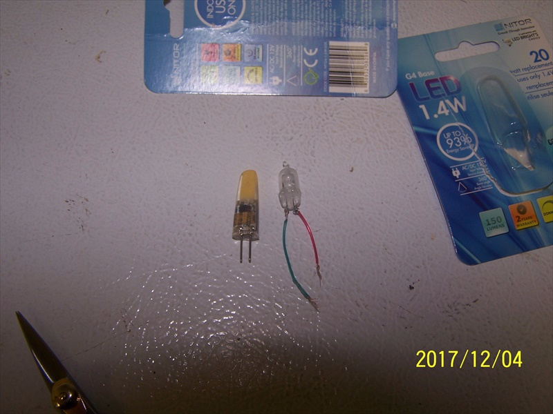

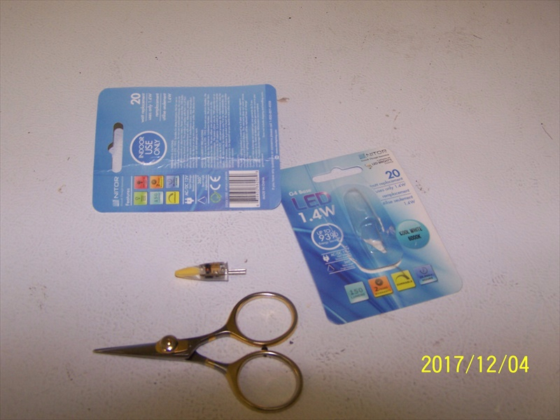

Last week I was trying ( and still am ) to find the source of a current drain on my battery. I removed the panel from the rear door to check the latch and while there found out my van IS equipped with the bulbs to light up “Delica“ on the rear door. I searched through the L300 section of tech stuff and in general followed Profister's lead. (viewtopic.php?f=98&t=2143 ) I did upgrade to LED's equivalent to 20W incandescent which should be much brighter than the 8W units he used. Very impressed with the results. Only problem may be the LED's I used are for indoor use which I only found out when I went to install them.
- Size and packaging for LED
- 100_8341a.JPG (311.14 KiB) Viewed 18382 times
- Old bulb and new LED
- 100_8342a.JPG (330.33 KiB) Viewed 18382 times

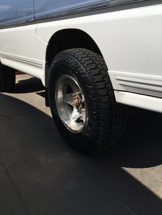

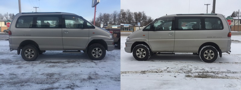

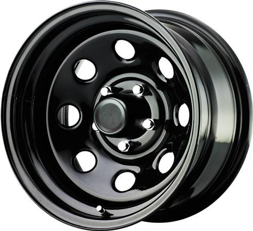

2" lift kit installed today! Alignment is next. Rancho RS9000 series shocks on the way for all four corners.
I'm looking at these rims:
Pro Comp Rock Crawler Series 97, 15x8 Wheel with 6 on 5.5 Bolt Pattern - Black 97-5884
with Duratrac's 31x10.5x15
and these fender flares:
Pacer Performance 52-192 Flexy Flares Black 1-3/4" x 58" Heavy Duty Reinforced Rubber Fender Extension Kit - 4 Piece
https://www.amazon.ca/gp/product/B00029 ... YIK6Y9EEQB
Any advice is greatly appreciated!

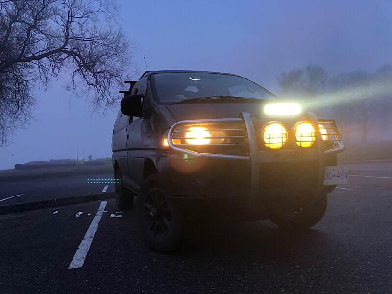

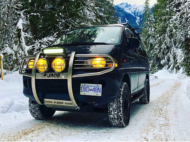

Installed new JAOS bullbar with CIBIE fog lights and 14” BrightSource lightbar

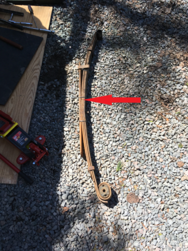

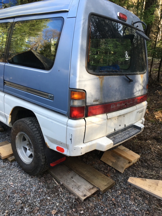

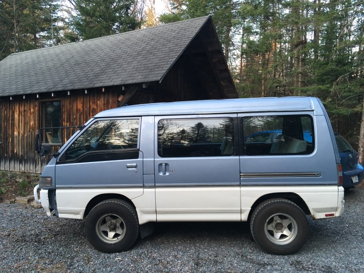

Well, I bought this one (named him "Wilson") last week in Edmonton and drove it home to Wakefield, Qc, just north of Ottawa.
Tried to get it safetied on Monday but figured it wouldn't pass as Quebec safeties are notoriously tough, and it didn't. So over the last few days I have pulled off a rear leaf spring to have one broken leak replaced and reinstalled it , adjusted the rear brakes where the left side adjuster was seized but I took it apart and got it adjusting again, installed a new muffler, installed a rear top middle brake light, installed rear mud flaps, added reflectors front and rear sides, cleaned the front headlights (as in, took them apart and cleaned the inside as they were full of dust - actually thought one was burnt out but it was just really dirty!), replaced every burnt out bulb I could find, reattached the front filler panels using zip-ties and, tomorrow I will adjust the front left bearing...oh, and there is a sticker on the driver's door that says the tire size is 215 SR15 so I had to do a quick KIJIJI purchase of used tires ($40) as the 235/75R15 I JUST PURCHASED are "TOO big for the vehicle, monsieu".
Getting them swapped on Wednesday. Then, off to get it re-safetied and registered and plated. Then get the tires swapped back!!!

Hi Manitoba
The flexy flares work okay, may wrinkle a tiny bit in the flat top front fender wheels on the series 2 Deli. Not too many other solutions and certainly the price is good.
Try maching out a set of toyota mags. The centers need maching out but a much better idea than black steel rims. The offset is greater as well. I found a set cheap on craigslist. Talk to your tire shop about the rims, mine told me which ones to buy.
have fun

And now it is safetied and registered and on the road...

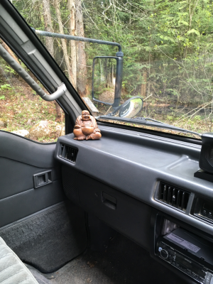

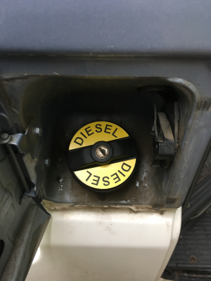

I was at the pumps the other morning, no coffee in yet, had the gasoline pump nozzle in my hand...."WTF!!!"...took some affirmative action...

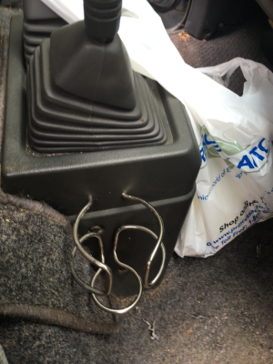

Also, so I can not be in a zero caffeine state at the pumps again, cup holders!
Ans, for good karma generally...Buddy

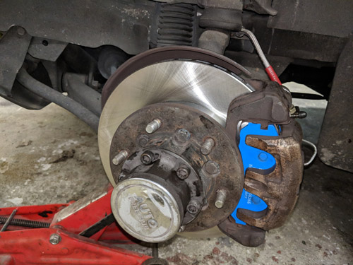

"I think the left front wheel locks up first" quickly got out of hand. Stripping and rebuilding the callipers, fitting thicker discs (from a Pajero or Pajero Sport), and a set of thoroughly mental Pagid RS5 brake pads because the race brake guy loves Delicas too.
And tomorrow, I get to bed the pads in! From the Pagid break-in procedure: "10 stops with low pressure from 150kph down to approximately 80kph, followed by a sequence of 5 stops with medium to high pressure from 180kph to approximately 60kph..."
I'm not sure the van will survive being pushed off a cliff 15 times, but we'll see.

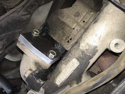

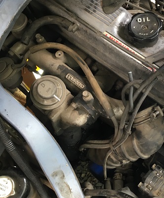

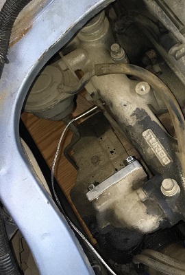

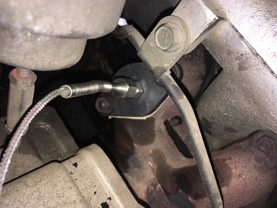

Today, a rainy day...
I performed the EGR removal operation.
Now you see it...
now you don't...
I used some 3/8" steel I had on hand (overkill) for the blanking plates and installed an EGT probe while I was in there.
Hoping to get the EGT gauge installed later this weekend, maybe a Turbo Boost gauge, too...
[adden-dumb: got in to test drive Wilson and discovered I'd buried the seat belt buckle under the seat when I reinstalled it
Now you see it...
now you don't...
