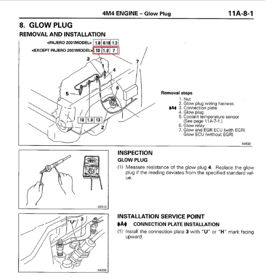

I have a multimeter somewhere, but I am a little sketchy on the directions for testing the plugs with it. I could take the plugs out and test them against the battery if I had the leads to do so, but I currently don't.
So, how do I use my multimeter to test the plugs, and, what are the "standard" OEM Mitsu plugs as I seem to get different answers from different places.

"Standard value" appears to be 0.5 ohms from page 11 A 1 2 of the 4M40 manual.
