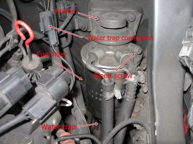

Right behind your coolant tank is you fuel filter, on top is a pump. Just loosen the little screw on there and press the top until fuel comes out. Then tighten it up again and presto.

Loosening the bleed screw will get air out of the fuel filter, but if your air leak is in the injection pump you'll want to leave the bleed screw closed while you pump the primer. (I'd try that first as it's less messy).

This shows where it is in the engine, tucked behind the coolant. The guy has taken out his batteries, but you don't need to do that in order to prime it, only to change the filter.
