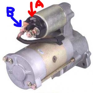

Before you go spending all the moneys, try a couple of tests for me?
Make sure it's in neutral.
Using one side of a pair of jumper leads, apply 12V to the small spade terminal (A, red)
If the starter runs, you have a wiring fault between the starter relay and the starter spade terminal- or a burnt out/faulty fusible link in the battery compartment.
If the starter doesn't run, apply 12V to terminal B (blue). That's the terminal with the braided wire bolted to it, not the terminal with the battery power feed (though it's not a problem if you connect to the wrong terminal. Heck, try them both just to be sure). That runs the motor directly. If the starter now runs, you have a fault with the starter motor solenoid- the large cylinder with all the terminals on top of the starter motor itself. Starter solenoids are much cheaper than entire starter motors.
If the starter doesn't operate for either test, the motor is burnt out.

"1. Using one side of a pair of jumper leads, apply 12V to the small spade terminal (A, red)
2. If the starter runs, you have a wiring fault between the starter relay and the starter spade terminal- or a burnt out/faulty fusible link in the battery compartment.
3. If the starter doesn't run, apply 12V to terminal B (blue). That's the terminal with the braided wire bolted to it, not the terminal with the battery power feed (though it's not a problem if you connect to the wrong terminal. Heck, try them both just to be sure).
4. That runs the motor directly. If the starter now runs, you have a fault with the starter motor solenoid- the large cylinder with all the terminals on top of the starter motor itself. Starter solenoids are much cheaper than entire starter motors.
5. If the starter doesn't operate for either test, the motor is burnt out."
