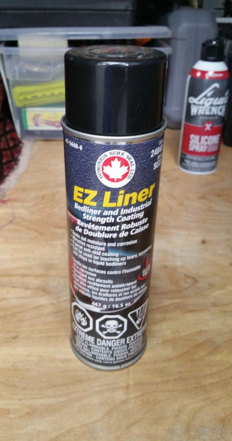

Sorry for the late reply. I visited a few places in US to get an estimate and it was somewhere around 600-1000 USD. It didn't make sense to me since the rust is from inside and its going to come back up again anyway. I am down in Seattle, but I picked up a few cans of the bedliner material when I was up in Vancouver. Attaching an image. There might be more brands available but the auto store that I visited only had this one. Only problem with bedliner is that it just covers the rust and doesn't do anything to reduce its spread. i.e. the rust will continue spreading and eventually bubble up through the bedliner. So what I did for the roof was Scrape off as much rust as possible, treat the remaining with rust treatment so it will neutralize it, then apply the bedliner.
Few things about rust treatments is that there needs to be rust for it to work. Also some actually cause rust if applied to bare metal according to their documentation. Others don't. One I found that doesn't seem to cause rust and in fact is used on bare metal as pre-treatment is Ospho 605 Metal Treatment. A friend also recommended Rust-Mort but I haven't read up on that as much as I did Ospho. You should definitely read their documentation though on application, etc. to make sure its used properly. Its pretty much an acid so will effect paint, etc...
But obviously if you want to really slow down the rust the best way is to also treat the rust from inside. My initial thought was just to treat it from outside and repeat every 6 months or so. But since I'm taking the headliner off for more headroom it makes sense to do a more thorough job.
