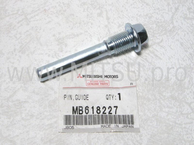

MB618227 top pin (plain pin). CAD$11 from Amayama.com

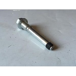

MB618228 lower pin (with rubber tip) CAD$10

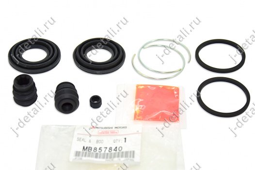

The lower pin is supplied without the rubber. To get the rubber you need rebuild kit MB857840 (superseded by 4605B977 CAD$30)
To rebuild both sides you'd need 2 of each part number. The rebuild kit comes with all seals and the magic special grease that stops the pins from seizing for at least 30,000km. <--Sarcasm! but the genuine grease does seem to work better than regular grease.)
