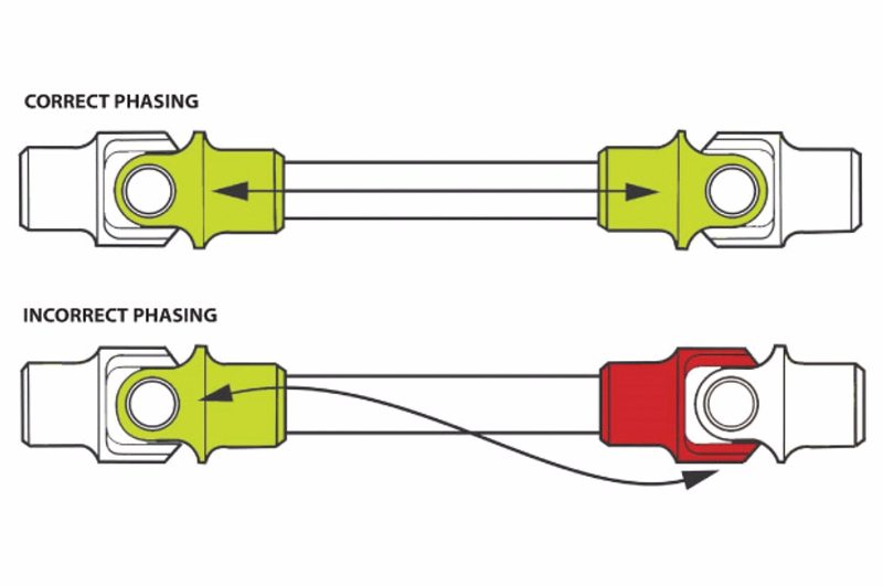

Here's a tip: if the back half of the driveshaft falls out, take care when reattaching it that the universal joints are aligned. If you reinstall it one spline out it'll look ok, and you might not feel the vibration, but the vibration will cause the splined section to spit all its grease out, and then it'll make an utterly terrifying noise when coasting.
The yokes at each end should align like this: If you've recently rebuilt your rear differential, or installed a new engine, or had your gearbox rebuilt this noise might cause you some anxiety, and maybe a day or two of crawling under the van checking everything.
Everything except the rear driveshaft, that is.
*sigh*.
