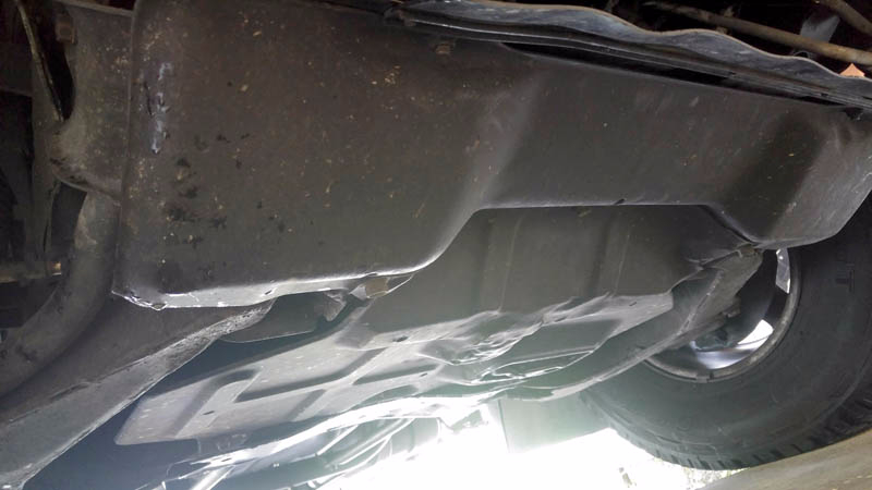

An aluminum skid plate was available which covers most of the front. Not a good picture but I think yo can see where is.

Thanks! this confirms that I'm definitely missing all plates except the forward one, not too concerned about getting a fancy upgraded one, but after the recent mud splatter fest in my engine bay during a good mud crawl I'm thinking it prudent to seek out the ones covering engine/diff/sway bar!

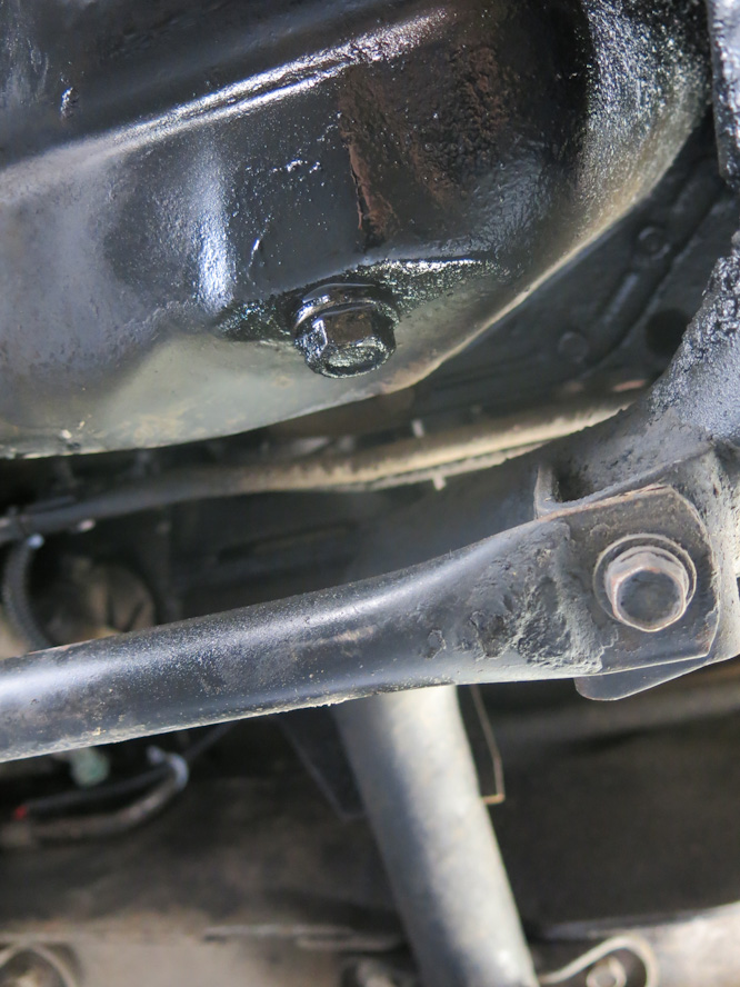

So I ended up with the largest skid plate shown in this picture, but the area I want to protect / catch oil in until I have time to replace rear main seal ... probably didn't come with a skid plate I'm deducing.Growlerbearnz wrote:20170311_113030 copy.JPG
I'm wondering if removing (then replacing) the four bolts, that hold the two bars in place under the oil pan (pictured above) would pose any problems? They appear to be connecting the frame of the van (???). I would like to attach a piece of metal to deflect mud and catch oil with an oil absorbing pad attached on top. I could just use some zap ties, but bolts + steel plate would be better I think.
I want to fix the leak and have a Rear Main Seal in my tool box, but in the meantime would like to catch the oil . . .

Those bars stabilise the engine mount frame (the big tube). I wouldn't drive without them installed, but removing them temporarily is easy enough. A strong skid plate bolted into the two bars' mounting holes would do the same job as they do.sealica wrote: I'm wondering if removing (then replacing) the four bolts, that hold the two bars in place under the oil pan (pictured above) would pose any problems? They appear to be connecting the frame of the van (???).
You're correct that the sump and oil drain does not have a skid plate from the factory.
Your oil leak looks like it's mostly coming from the oil drain plug, maybe a new sealing washer would fix most of it? The rear main seal leak mostly comes out the little hole in the transmission bellhousing. Though of course there are many, many other places higher up on the engine that leak, it could be dribbling down from above.
