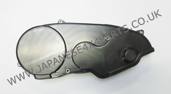

You should be able to check your timing without removing anything more than the top half of the timing belt cover, and you don't need to remove the fan or radiator.
Remove the five 10mm bolts and the cover comes free. Two of the bolts are longer than the others (but different lengths) so keep track of which long bolt goes in which hole. You *might* need to remove the drivers' side engine cover to get at the bolt on the far side of the cam sprocket- I can do it with the cover in place, but I know where the bolt is and have done it a couple of times.
If the timing is correct (check the link in my previous post to see how the timing marks should line up) then I'd remove the rocker cover and check for broken rockers, and that the camshaft rotates when the rest of the engine does. Turning the engine by hand, of course. Cranking the starter will spit oil everywhere :-)
