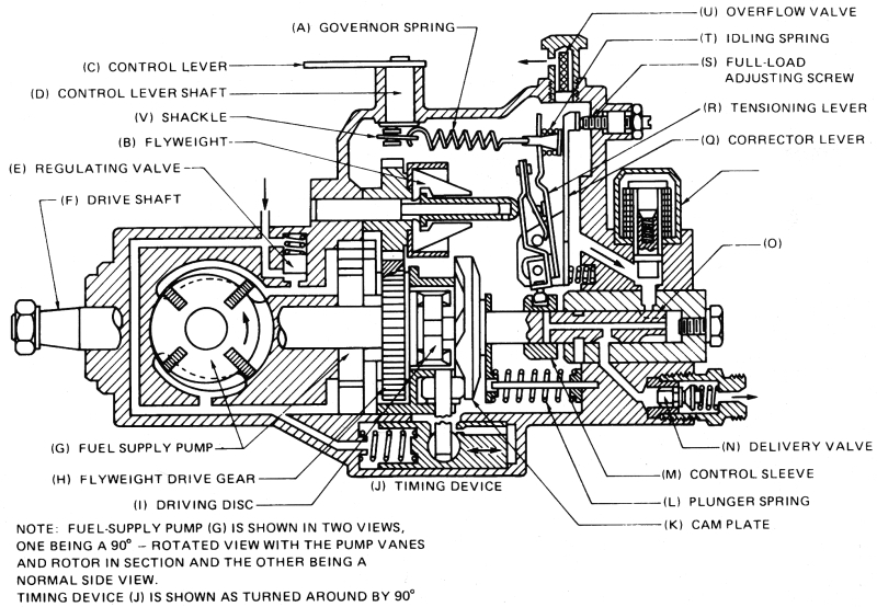

Had to put this one on the shelf for a moment, but back to it. So there are two fuel lines coming off of the fuel tank. One goes to the fuel filter, the other directly to the back of the injector pump. So. Got some hoses. But now I'm confused about which one-or-more hoses to run to the external can fuel?
Do I just take the fuel-filter side of line "V" off and drop it in a bucket-o-fuel?

Helps if I attached the picture.

You've got it. Drop V into bucket of fuel, watch W for bubbles.
It took me a moment to figure it out though: This diagram is the fuel tank side of the fuel lines. V is fuel supply to the injection pump, W is fuel return from the pump to the tank.

Just curious - why is there a return line to the tank? What purpose does that serve? (NEWB)

The fuel supply pump (G) sucks fuel out of the tank, filling and pressurising* the interior of the injection pump. The Overflow Valve (U) sets the internal pressure and allows excess fuel to return to the tank. Without an overflow valve internal pressure would just keep building until the seals burst.
The injectors themselves also create a bit of excess fuel too- the (unlabelled) plunger (O) pushes a shot of highly pressurised fuel to the injector, which forces the injector open. As the plunger nears the end of its stroke the fuel pressure is no longer enough to keep the injector open and it snaps shut, diverting the last little bit of fuel to the return rail (the small wiggly pipe that's strung between all 4 injectors).
*Down the rabbit hole we go: To get the most push out of your fuel, you want it to ignite just as the piston starts to go back down the bore. Thanks to the laws of physics and chemistry there's a fixed delay of a few milliseconds between injecting the fuel and ignition, so as the engine goes faster you need to inject the fuel earlier to synchronise the moment of ignition with the piston. This is achieved by having the pressure in the injector pump drive the timing device (J). As engine speed increases, pressure increases, and the timing device moves the start of injection earlier so that the fuel continues to burn at the right time.
On later model engines they replaced the overflow valve (U) with a computer-controlled valve so they could regulate the pressure in the pump and injection timing independently of engine speed, allowing higher boost levels and more power output without the risk of blowing up the engine on a hot day.
