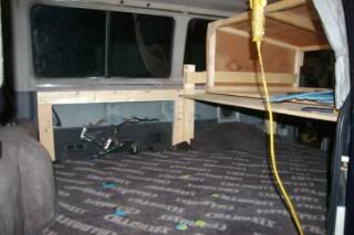

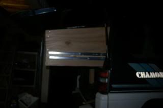

Not sure if this is the first Slide out or not?
But here is the start of my camper build, just roughed in right now.
Slider extends 3 feet using 4 heavy duty drawer slides. Lots of work ahead, but a good start.

Re: First Delica Camper Build with a slide out?
Why is that part sliding out? Is it for the head/feet or is it storage?
Post by thedjjack »
For the feet. Gives a 6+ foot bed and still have some floor space.
Post by thedjjack »
Rear gate up to sleep with lockable storage under the bed and then rubber seals that the slide put will push through to stop bugs/weather from coming in.

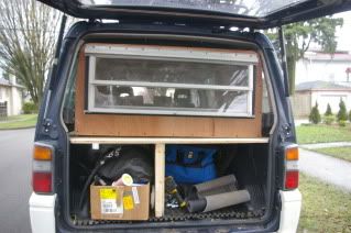

Post by thedjjack »

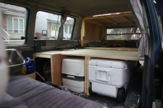

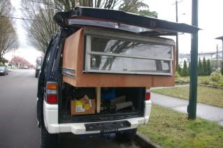

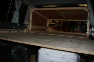

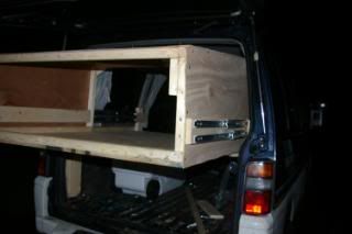

Recent Photos:
New Slide, Bottom divided (just need back storage doors and seals).
Still need foam for bed, counter built, rug everything pretty.
CLOSED
OPEN
CLOSED
OPEN
